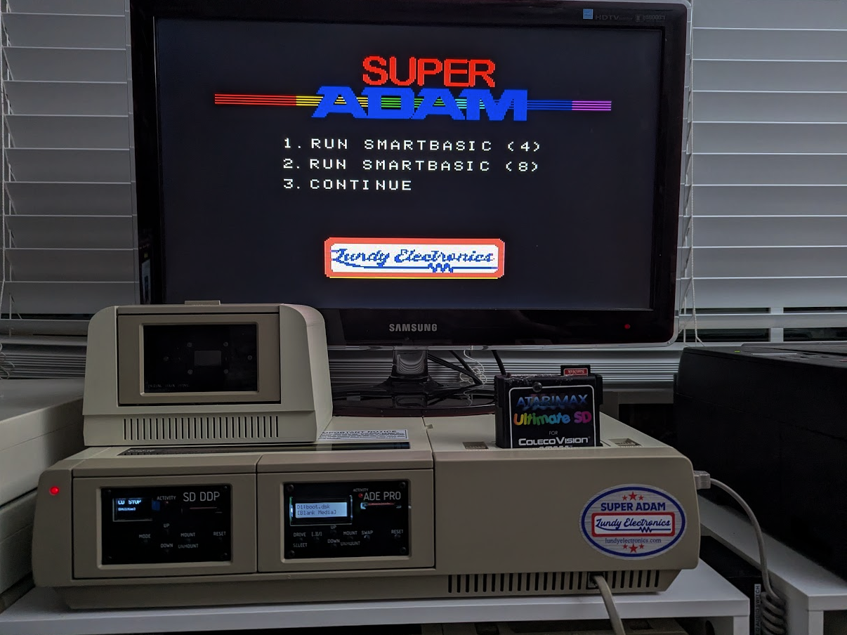

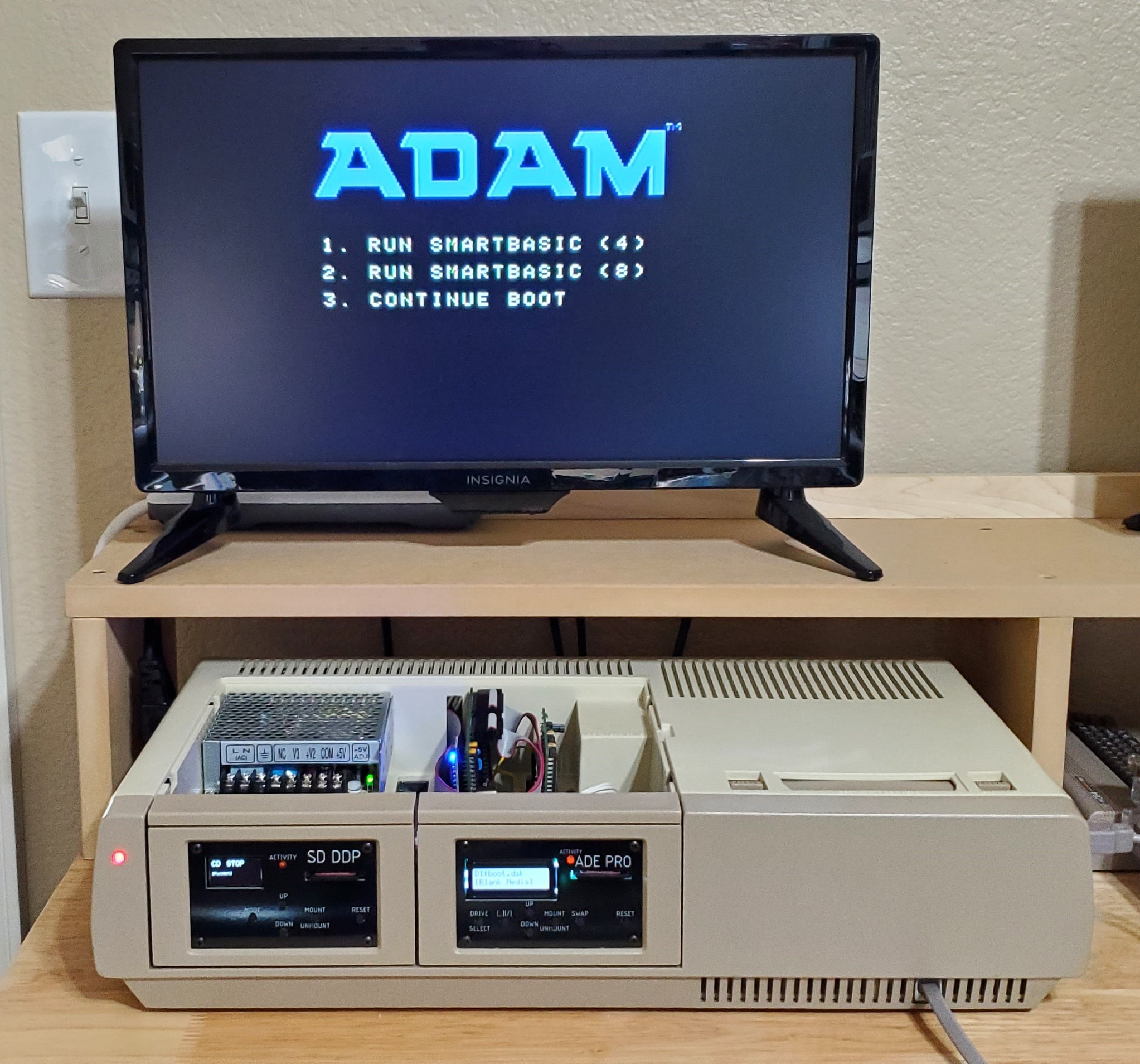

The SuperADAM
Modified by John Lundy — Lundy Electronics

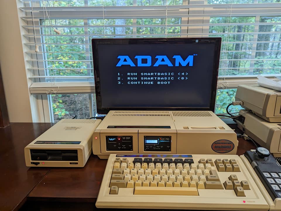

SuperADAM 2026
★ NEWEST MODEL
Unit arrivied April 2026
Modified by John Lundy (2026)

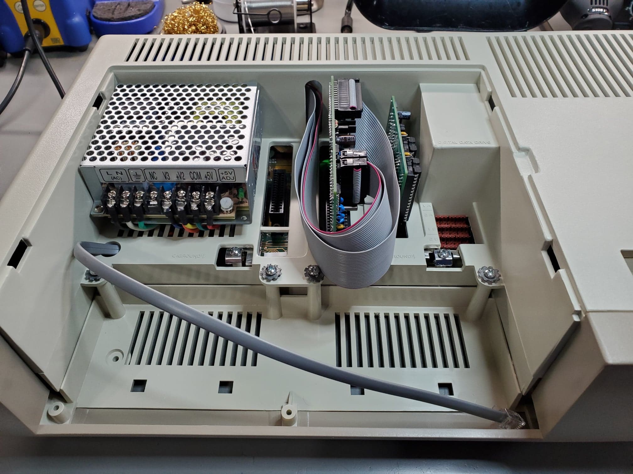

The most advanced SuperADAM ever built. Featuring rare dark beige consoles, a custom machined COM bracket, DRAM-to-SRAM conversion on both Delta and Gamma boards, and optional VGA output — all with nothing exiting the top cover.

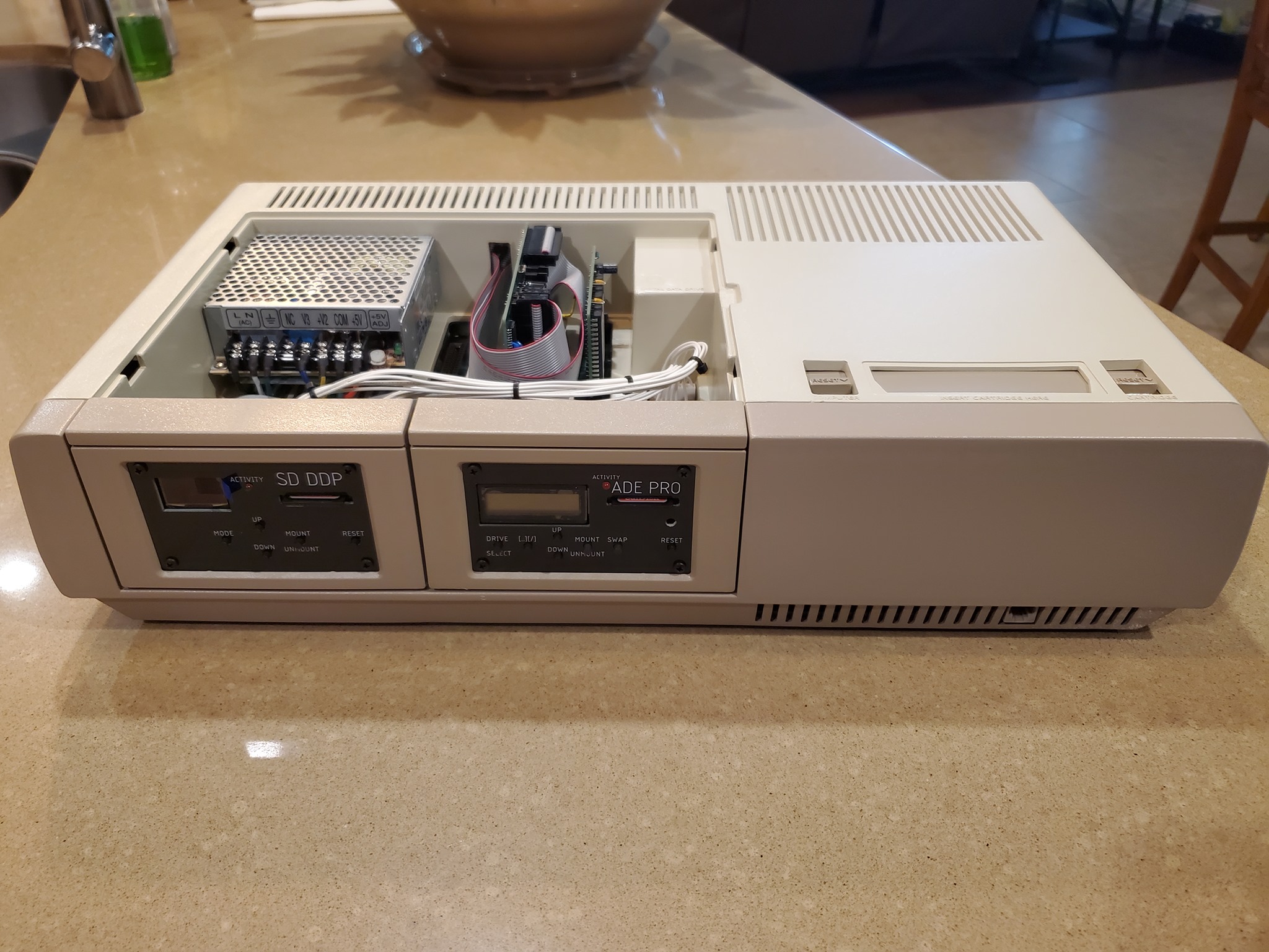

Case & Cosmetics
  • - Rarer dark beige bottom consoles for the first two units made available

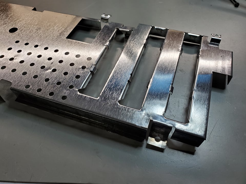

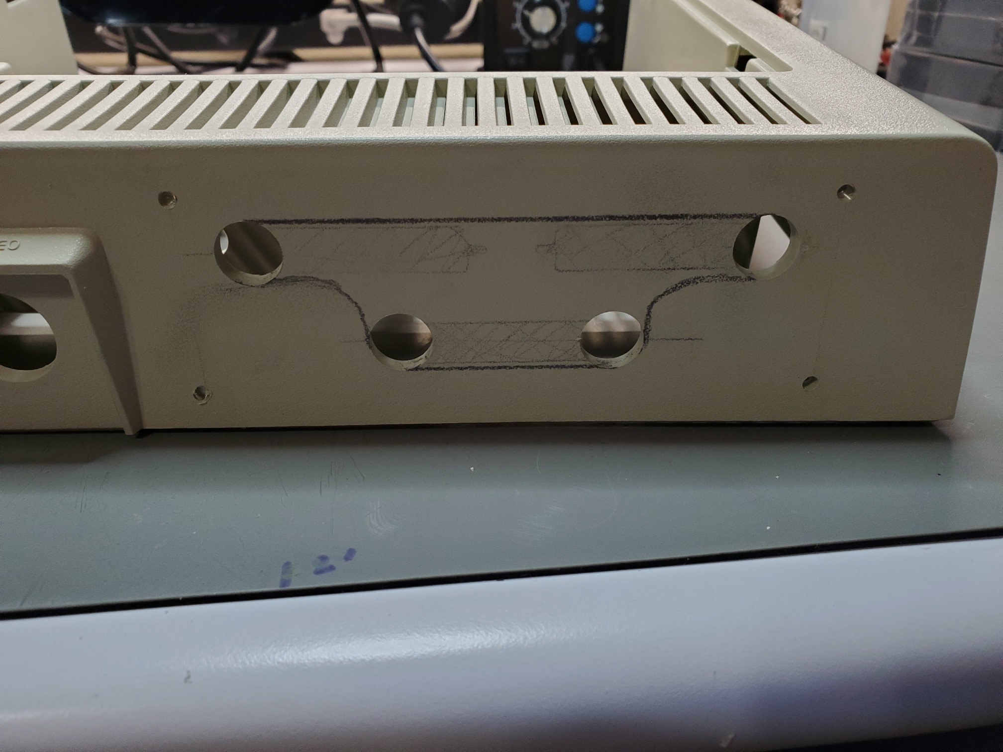

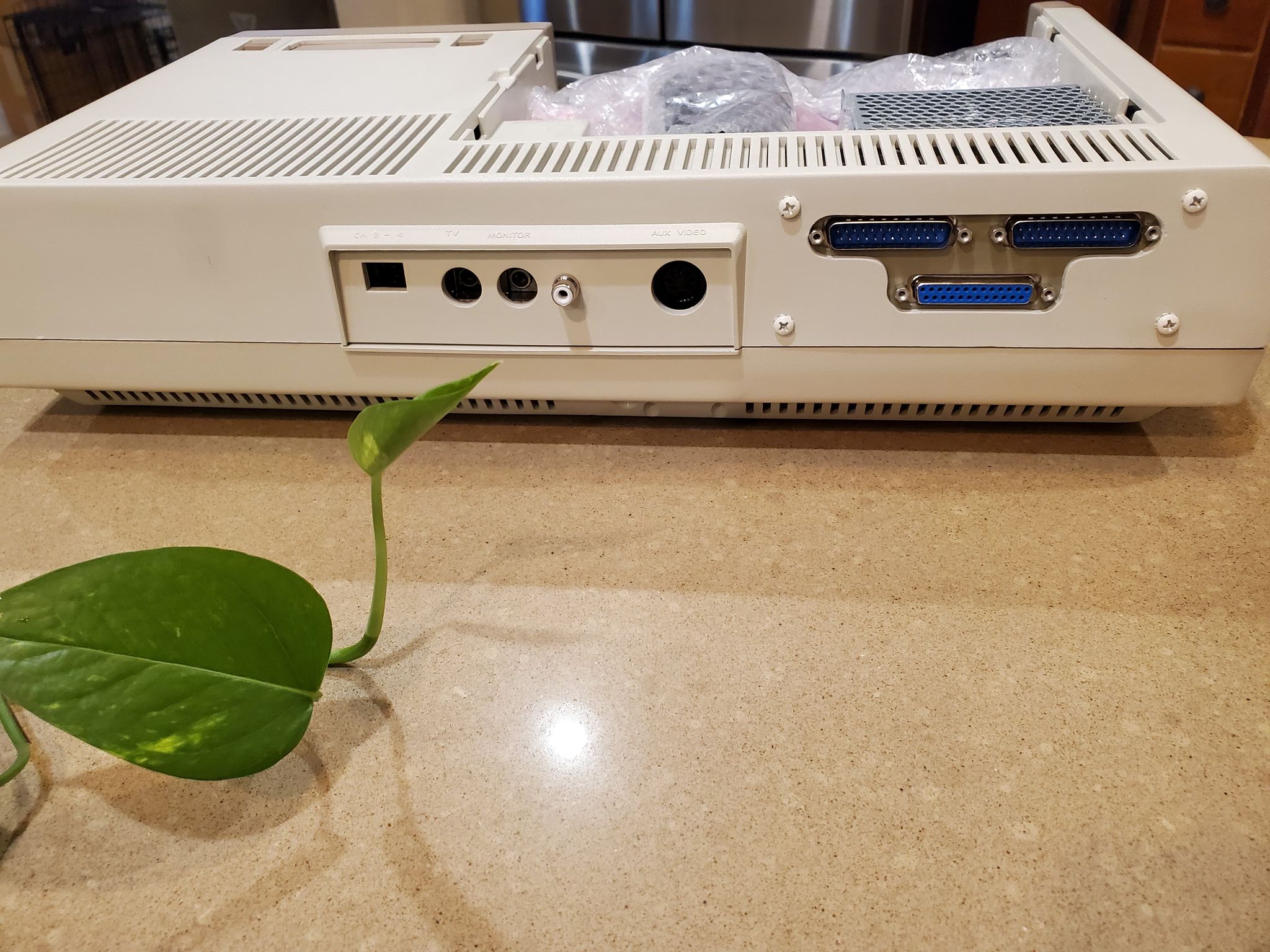

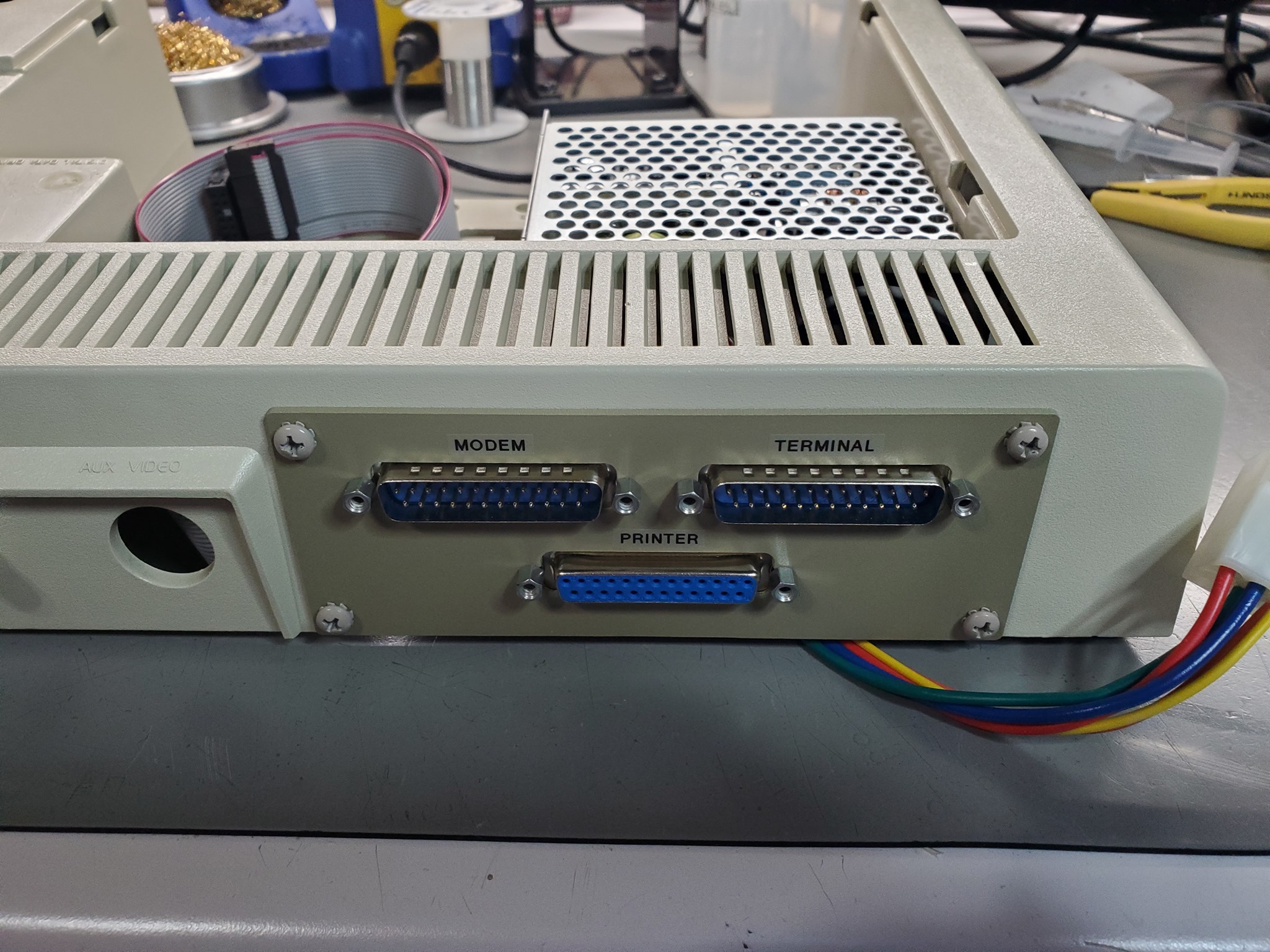

  • - Case modifications to cleanly route internal power supply, terminal, parallel, and external data drive cables utilizing a custom machined dark beige powder coated metal COM bracket mounted on the back. Nothing hangs out the top cover
  • - Professionally printed brushed aluminum SuperADAM front decal
  • - Thoroughly cleaned console with new label set. Best effort to find matching dummy data drive bezels to house the internal drive emulators
  • - New proper sponge rubber feet

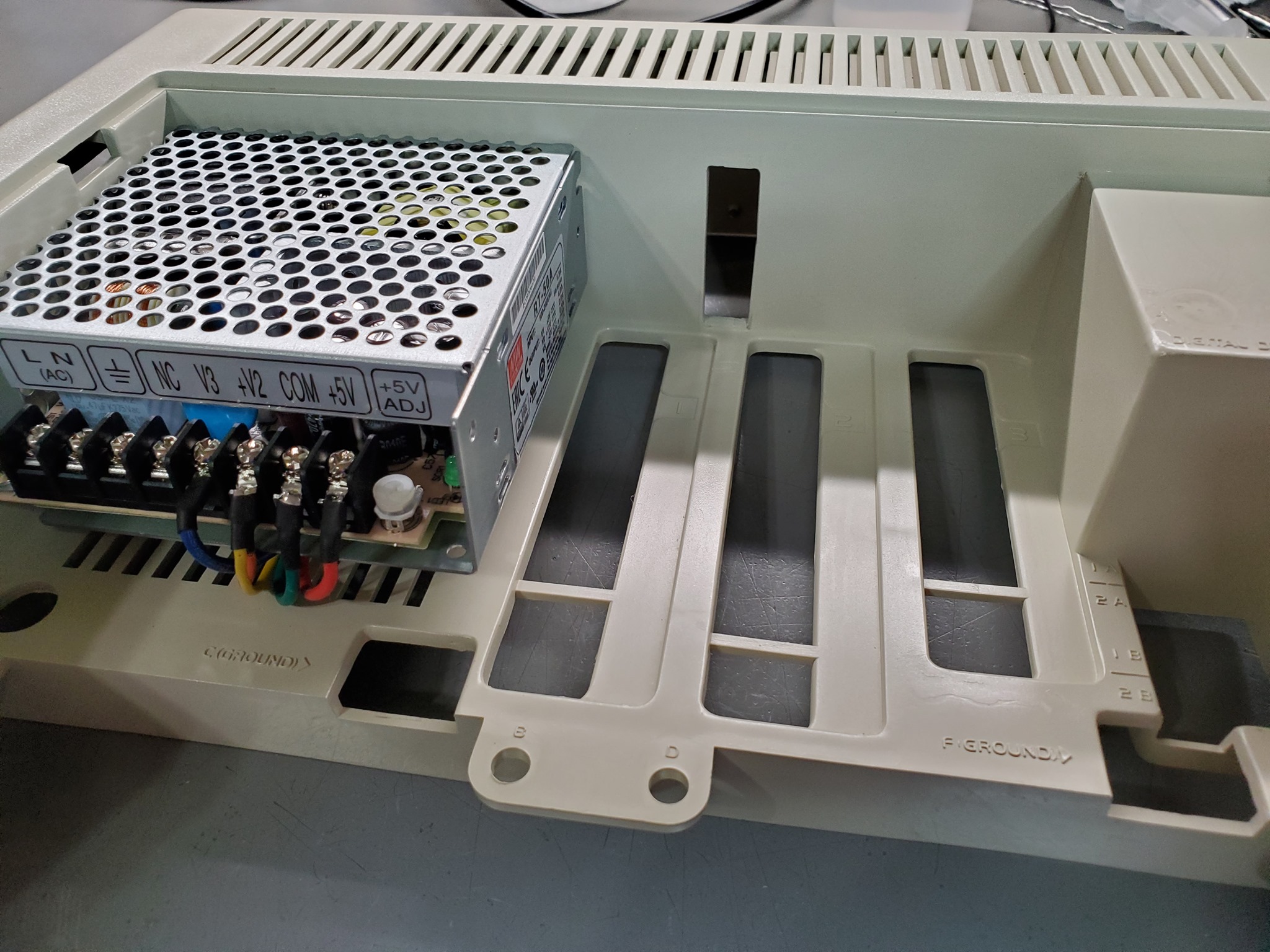

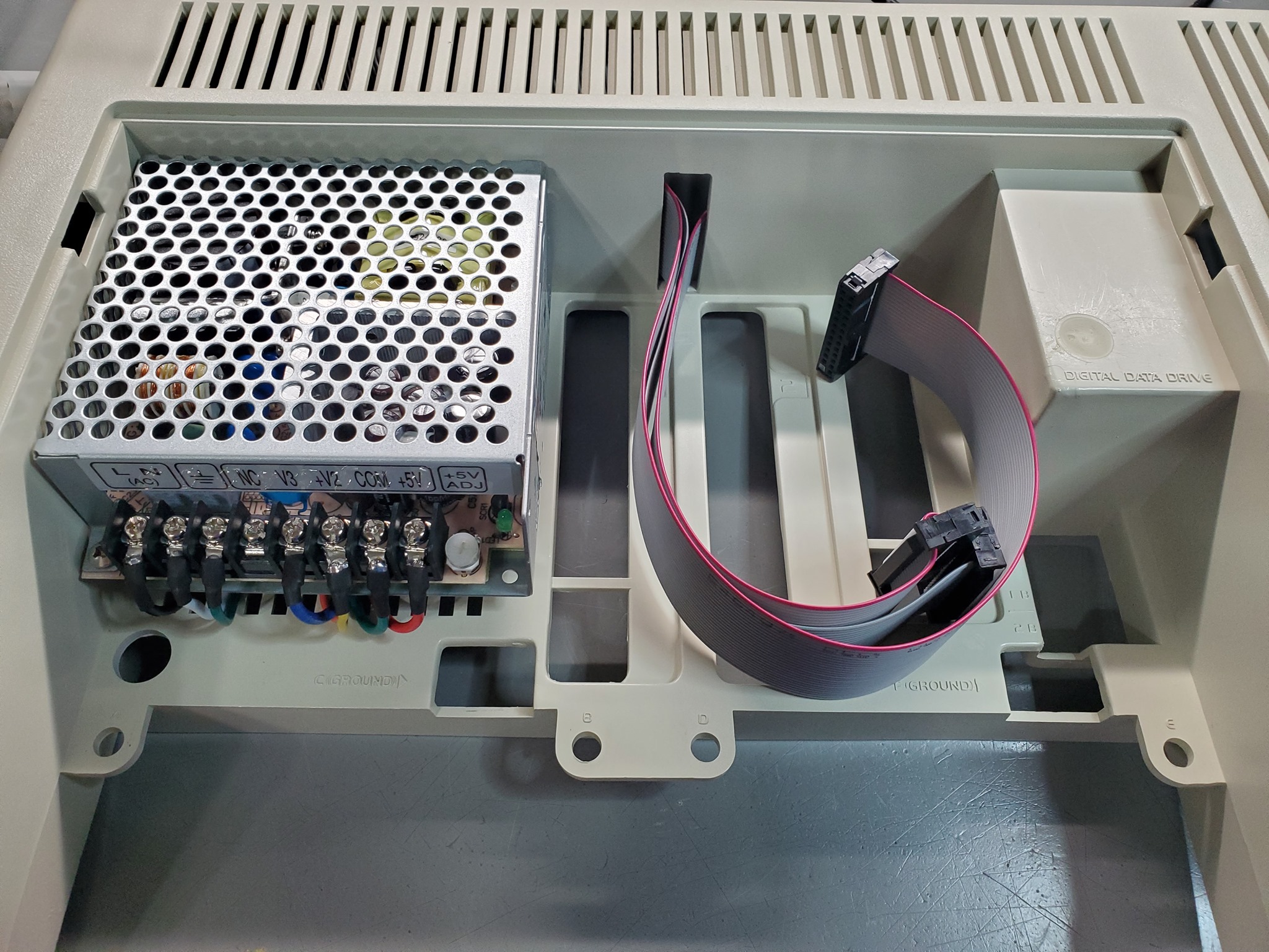

Power

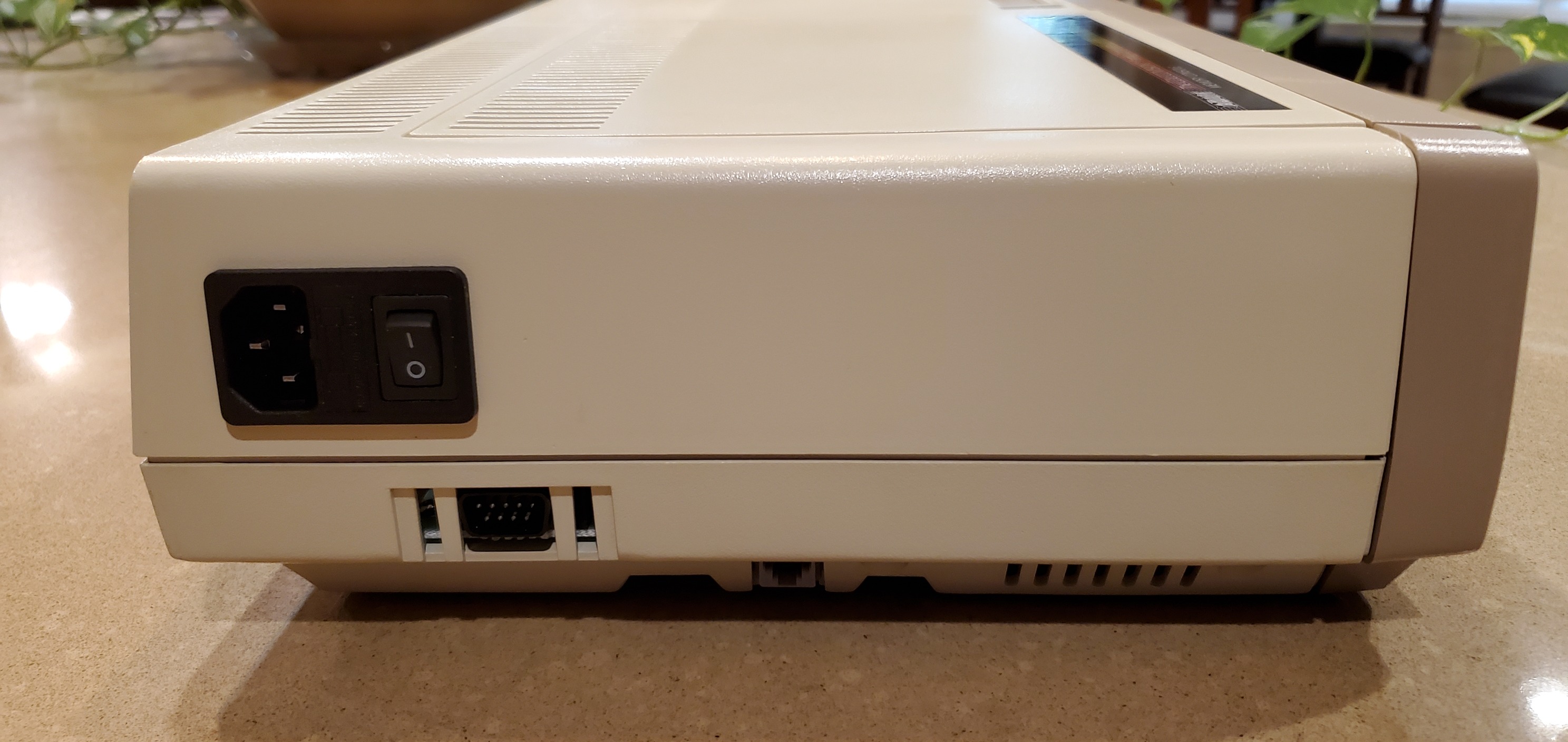

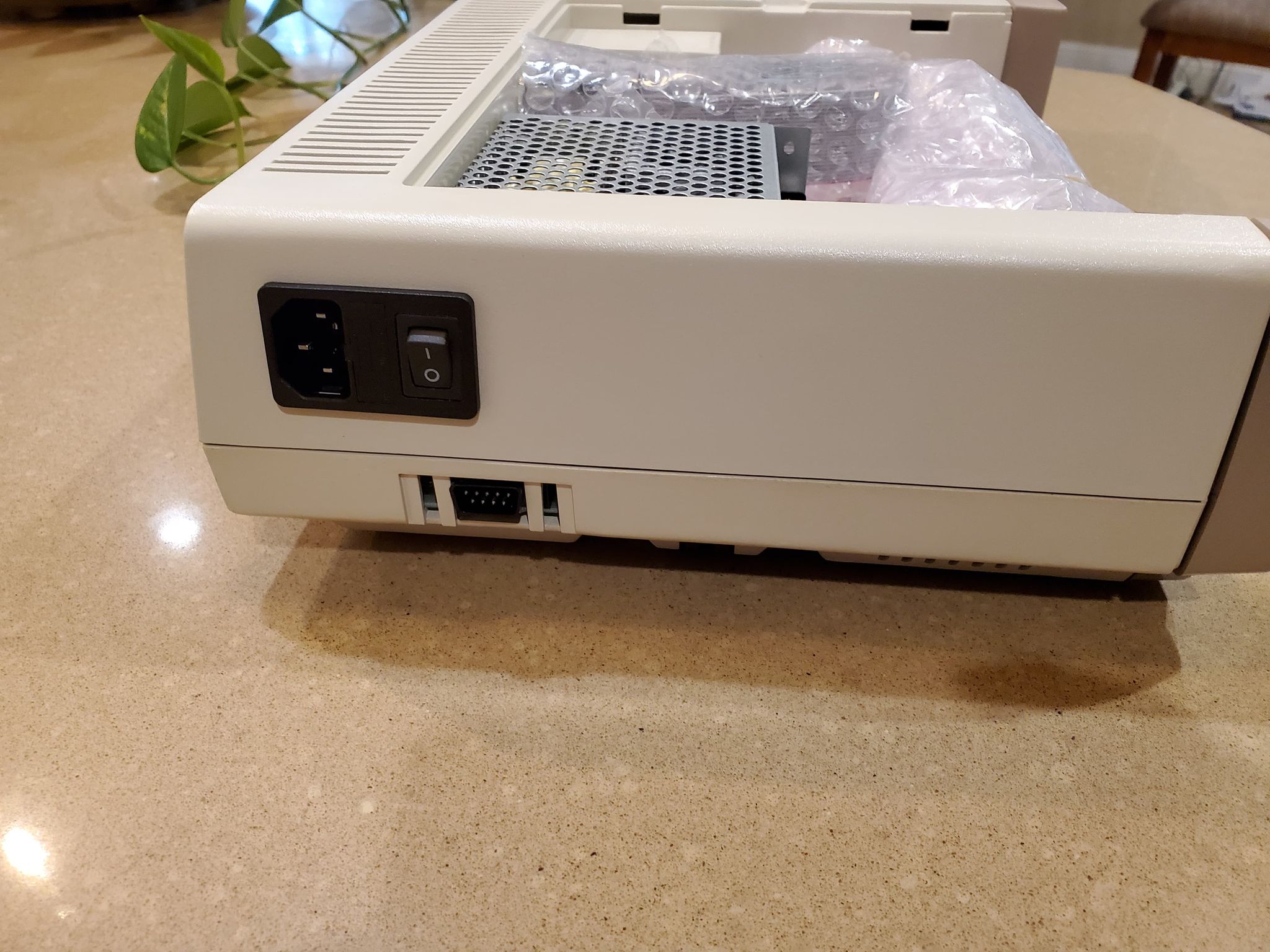

  • - Internal power supply
  • - Rear IEC fused power input module
  • - Left side mounted power switch towards the front
  • - Red LED power indicator on front left

  • - If video poll leans towards VGA: No-cut beige bracket covering the RF channel selector, TV, and monitor port area for VGA and audio out connectors. Can always be removed and use included original VDP to drop back to factory video. There is now a socket to make the change easily if desired
  • - If video poll leans towards composite only: An audio RCA connector will be added next to the monitor RCA connector. Will be recessed in its own hole for a factory look

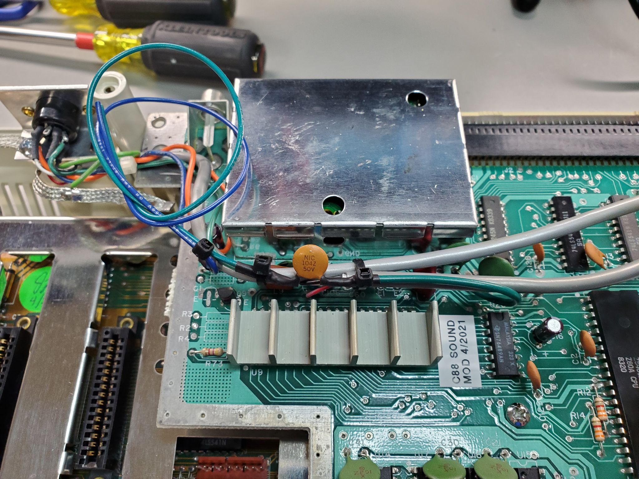

  • - Audio balance fix mod for using SGM and Speech Synthesizer

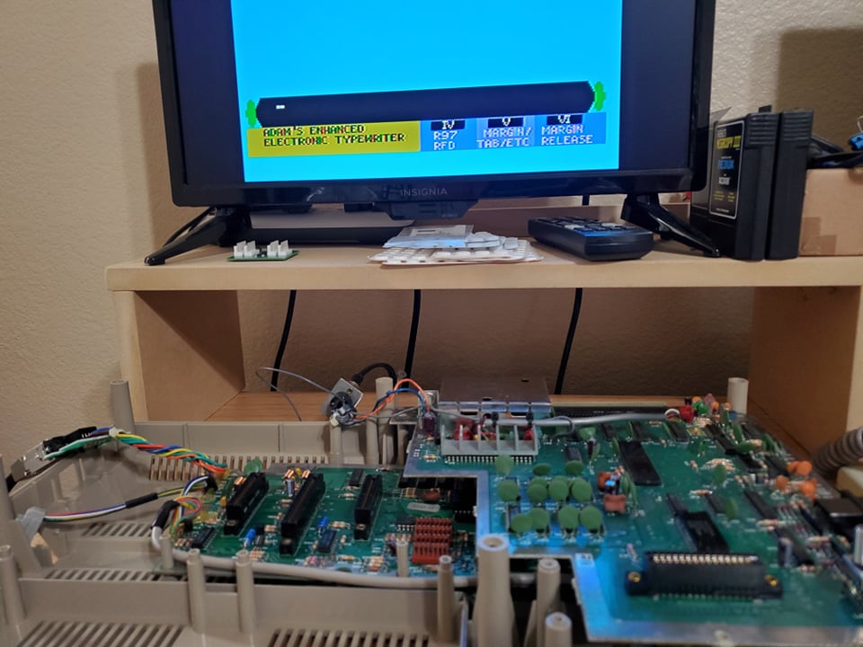

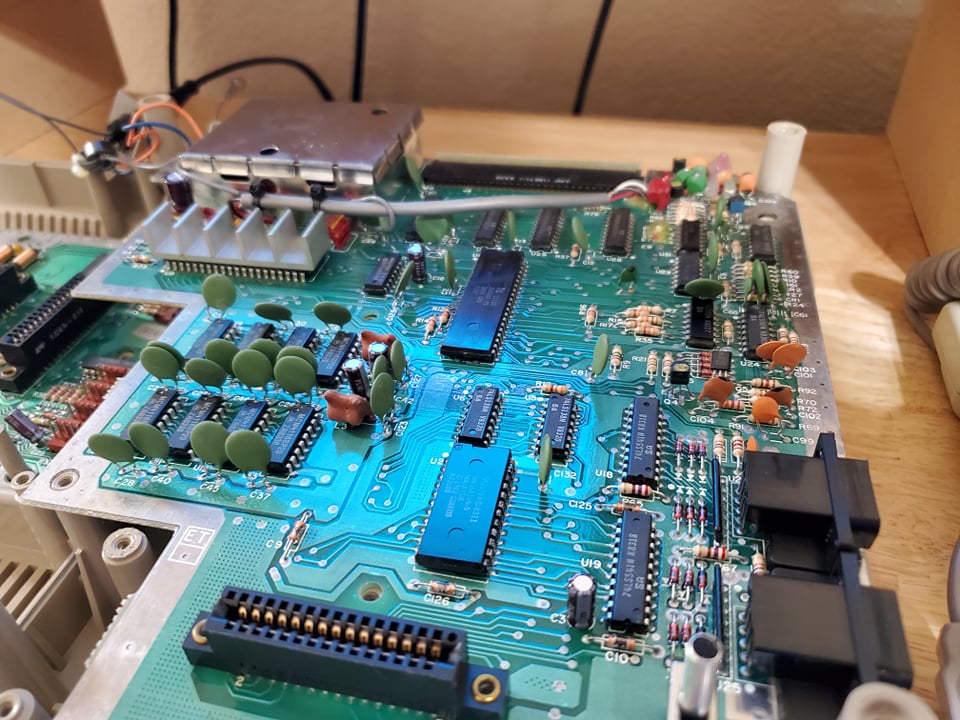

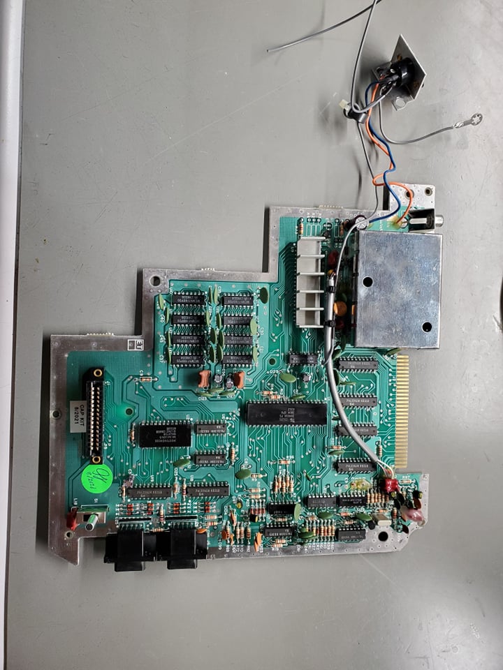

Board Upgrades
  • - Complete capacitor kit, including tantalum capacitors
  • - New cartridge connector for reliability
  • - Delta board DRAM to SRAM converter
  • - Gamma board DRAM to SRAM converter (new product — not yet publicly released)
  • - Thoroughly cleaned PCB and polished I/O fingers
  • - Ultrasonic cleaned joystick connectors

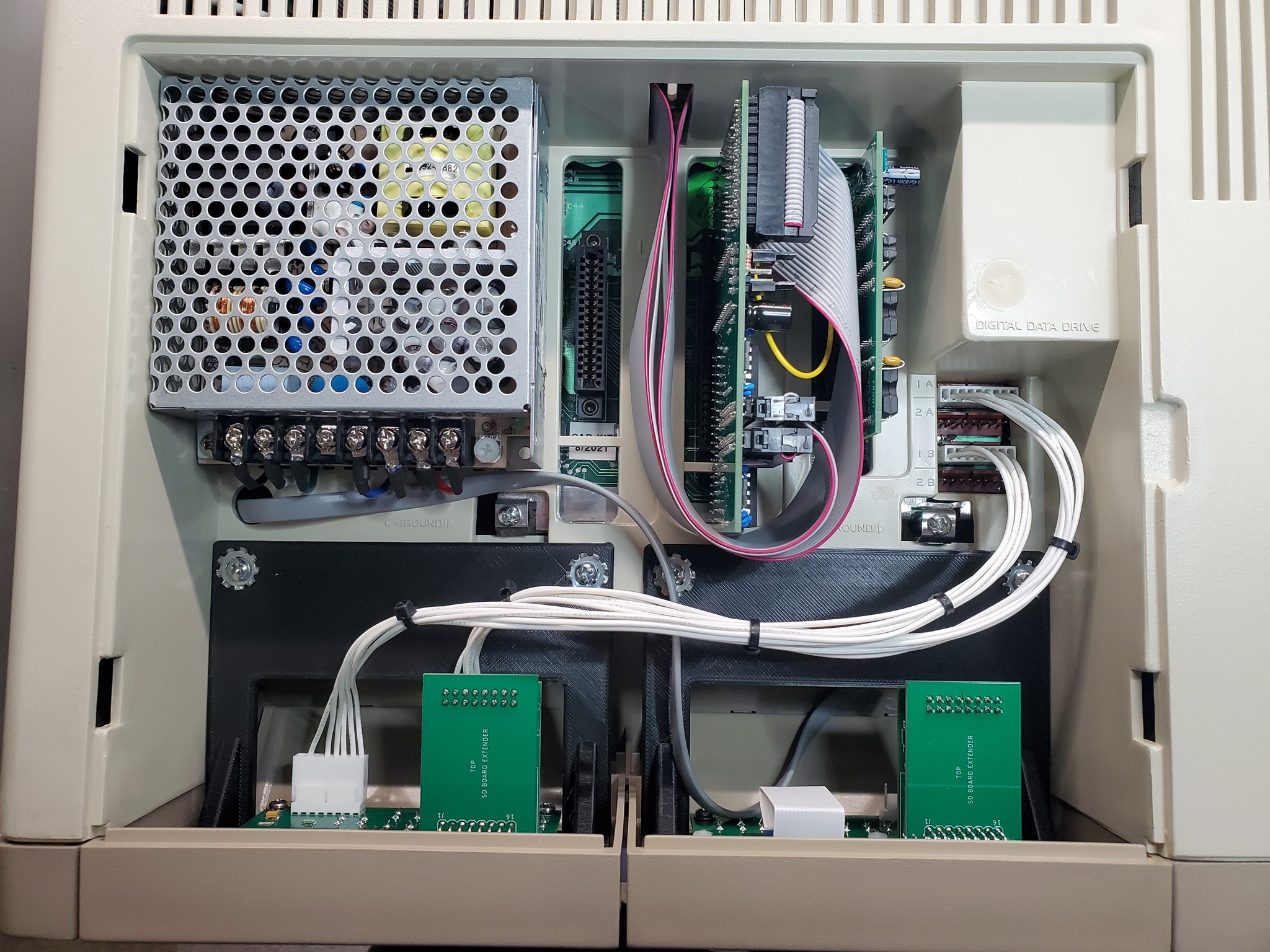

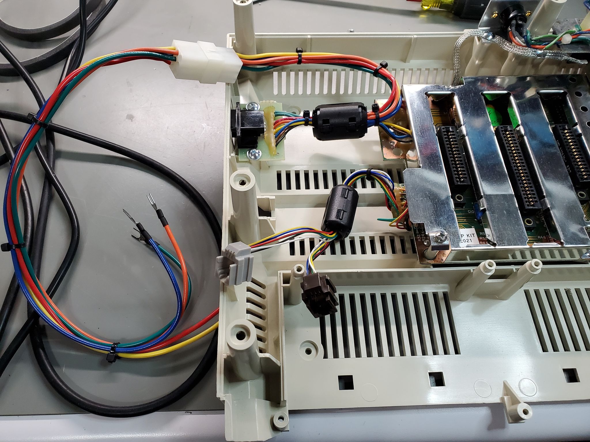

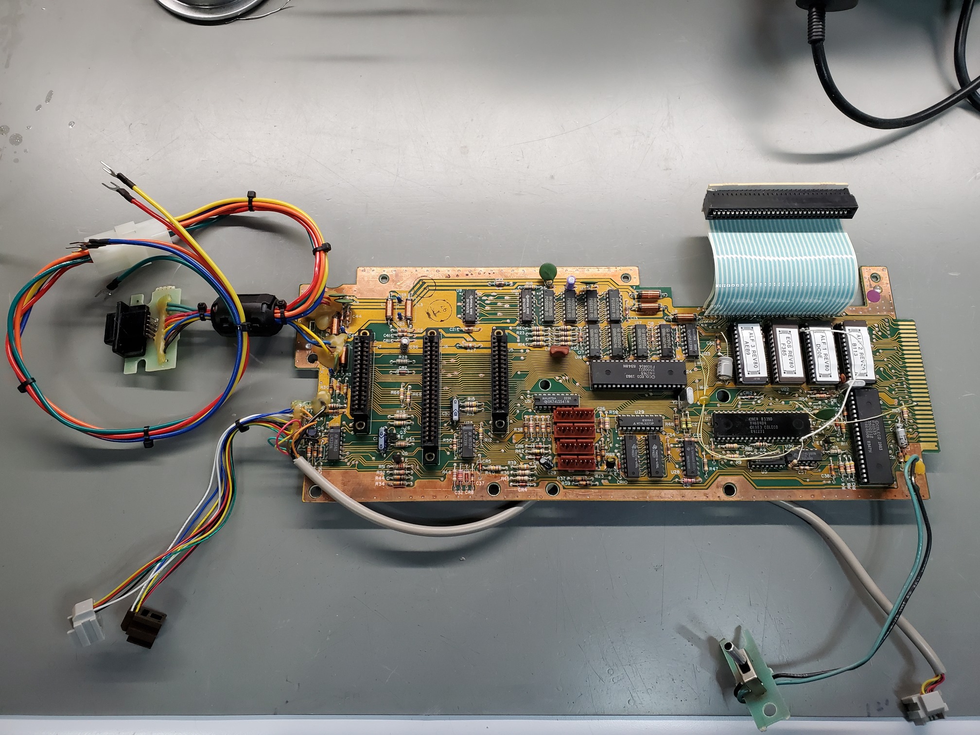

Connectivity & Expansion

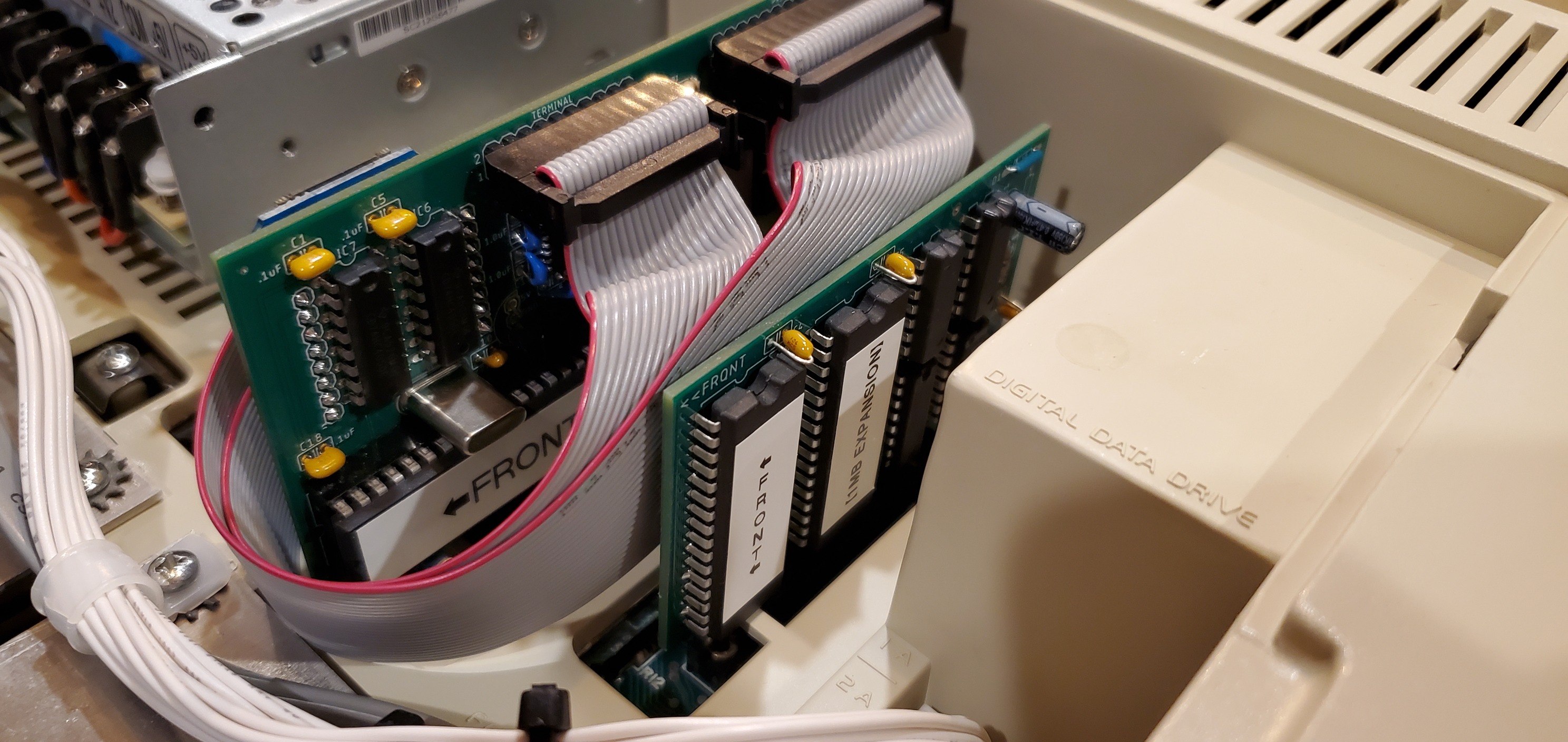

  • - MIB238-WiFi board (WiFi modem, terminal, parallel port, expansion ROM socket, and memory addressor signal generator connection)
  • - 1MB RAM Expander board
  • - Internal ADAMnet board connection with printer reset silencer. Still allows +5 out of side power connector to power a roller controller and factory printer ADAMnet connectivity

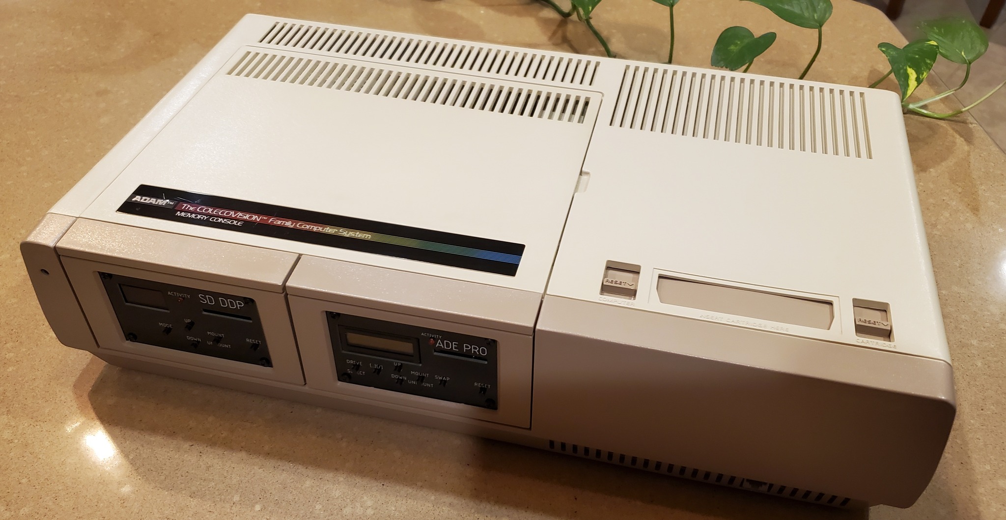

Storage
  • - Internal drive emulator (ADE)
  • - SD DDP (internal SD data drive)
  • - External data drive, housing, and cable
Software
  • - SmartBASIC XROM in MIB238 boot ROM socket — Console can boot instantaneously to SmartBASIC

  • - Console itself

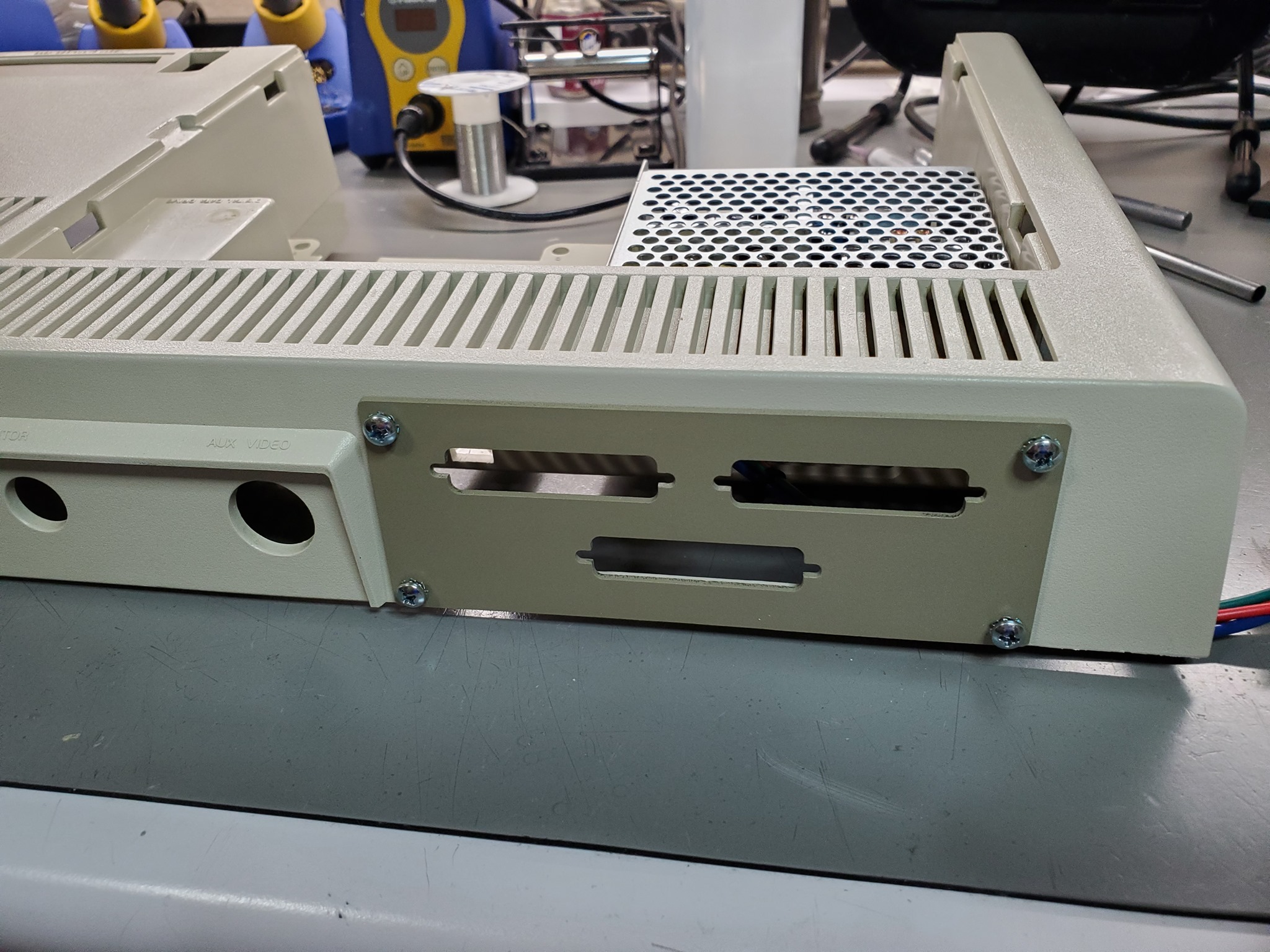

  • - Professionally machined and powder coated COM panel bracket designed just for an ADAM console
  • - All connectors ultrasonically cleaned for reliable connections
  • - All hardware polished to a chrome finish
  • - Other misc parts, materials, wiring, and connectors to make this modded console

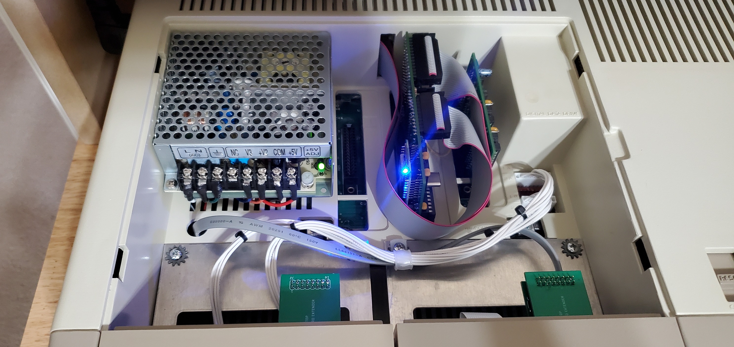

Power

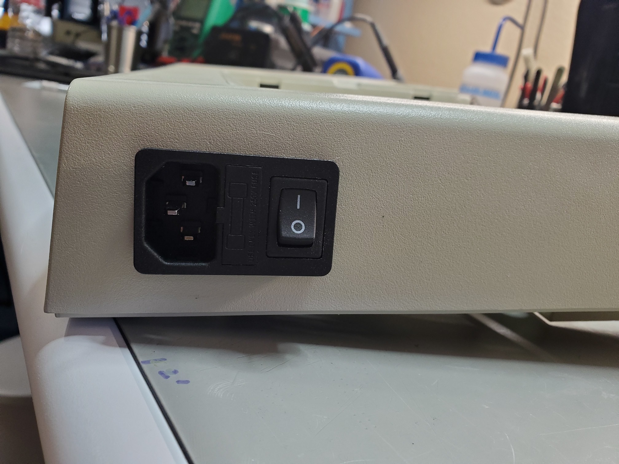

  • - IEC fused power inlet module and power cord

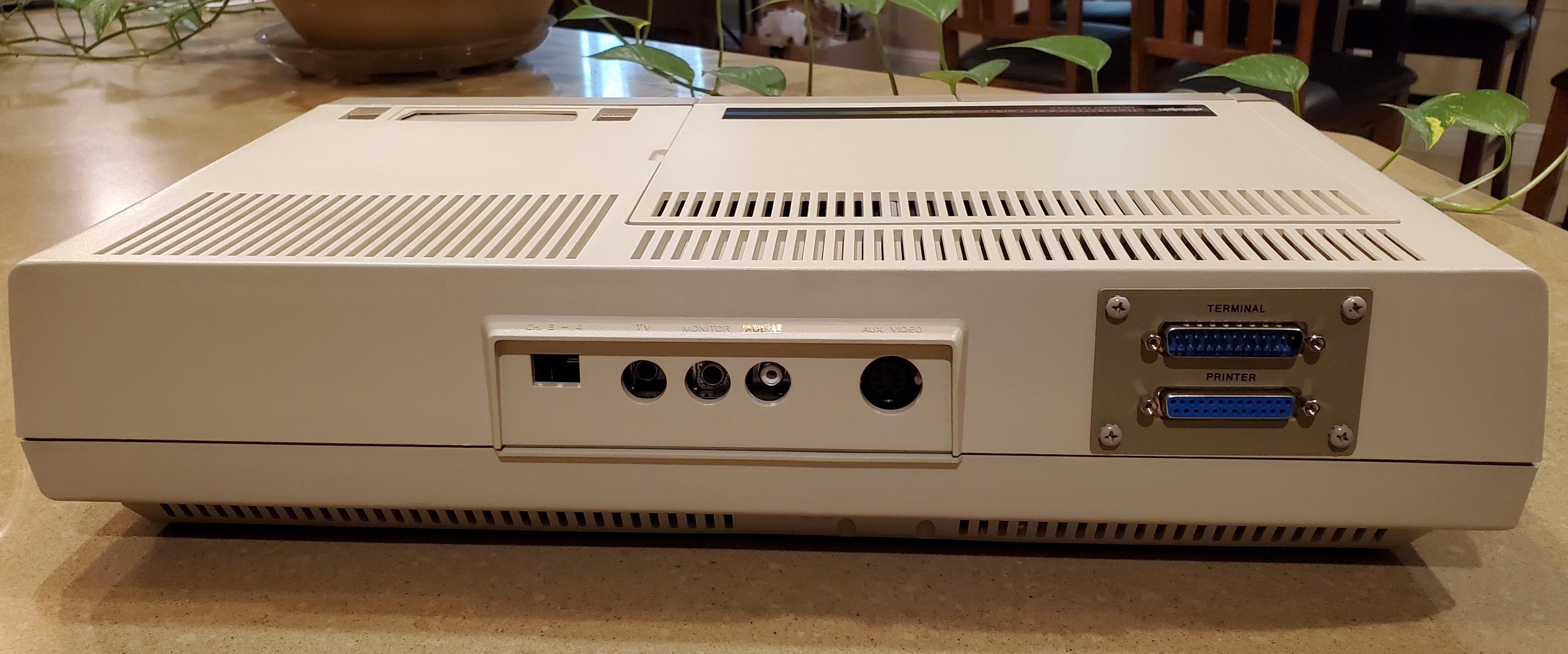

  • - Audio out RCA connector (audio can now be obtained without the need for the DIN connector)
  • - C88 sound balance mod

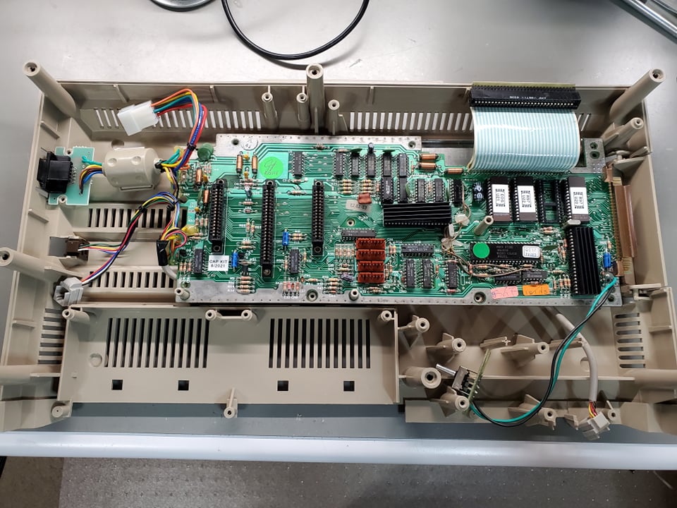

Board Upgrades
  • - All 4116 DRAM replaced with 4164 DRAM and sockets
  • - Complete electrolytic and tantalum cap kit
  • - MIB238-WiFi card (has WiFi modem, terminal serial port, parallel printer port, boot PROM, and memory expander signal generation connector)
  • - 1MB RAM Expander card
  • - Internal ADAMnet connector and cable
  • - ADAMnet to Coleco printer adapter with reset silence included for using a factory printer
  • - ADAMnet splitter to allow multiple ADAMnet devices on the single left side port if needed
  • - Two ADAMnet cables for future use
  • - 80-column terminal connector and internal ribbon cable
  • - Parallel printer connector and internal ribbon cable
  • - Memory expander signal wire
Storage
  • - Internal ADE Pro
  • - SD DDP

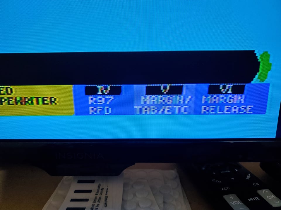

  • - SmartBASIC boot PROM with integrated AJM printer port #64 patch
  • - R89 SmartWRITER PROMs with parallel printer support built in

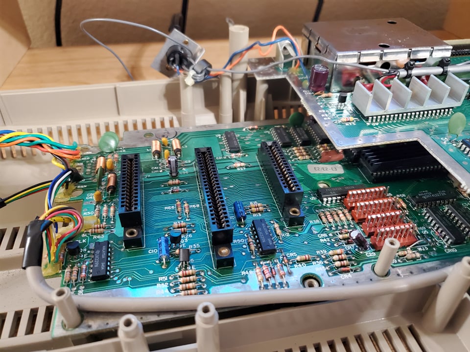

Board Upgrades
  • - Installation of console capacitor kit (also includes tantalum capacitors not supplied in other kits)
  • - New cartridge connector installation
  • - New all metal high quality 7-Pin DIN connector installation
  • - Ultrasonic cleaning of Gamma to Delta board connector and fingers
  • - Ultrasonic cleaning of existing 7-Pin DIN connector

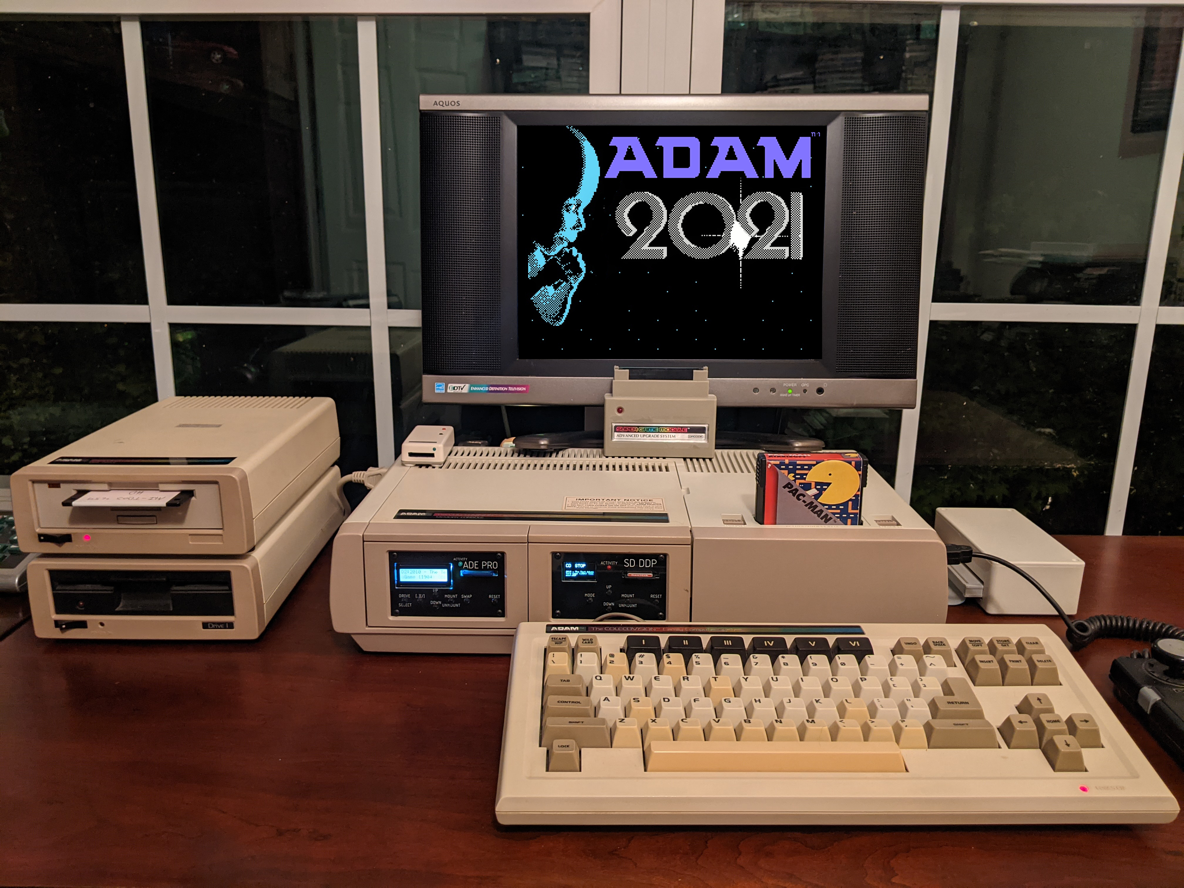

SuperADAM 2021
Modified by John Lundy (2021)
The original SuperADAM. The console that started it all — a fully modded ADAM with internal power supply, audio fix, and clean internal connectivity.
Power
Video & Audio
  • - C88 audio fix
  • - RCA audio connector
Board Upgrades
  • - Internal COM ports (2 serial and 1 parallel). *Requires an MIB238, MIB2, or MIB3 card
  • - Internal ADAMnet connection
SuperADAM 2021 Gallery

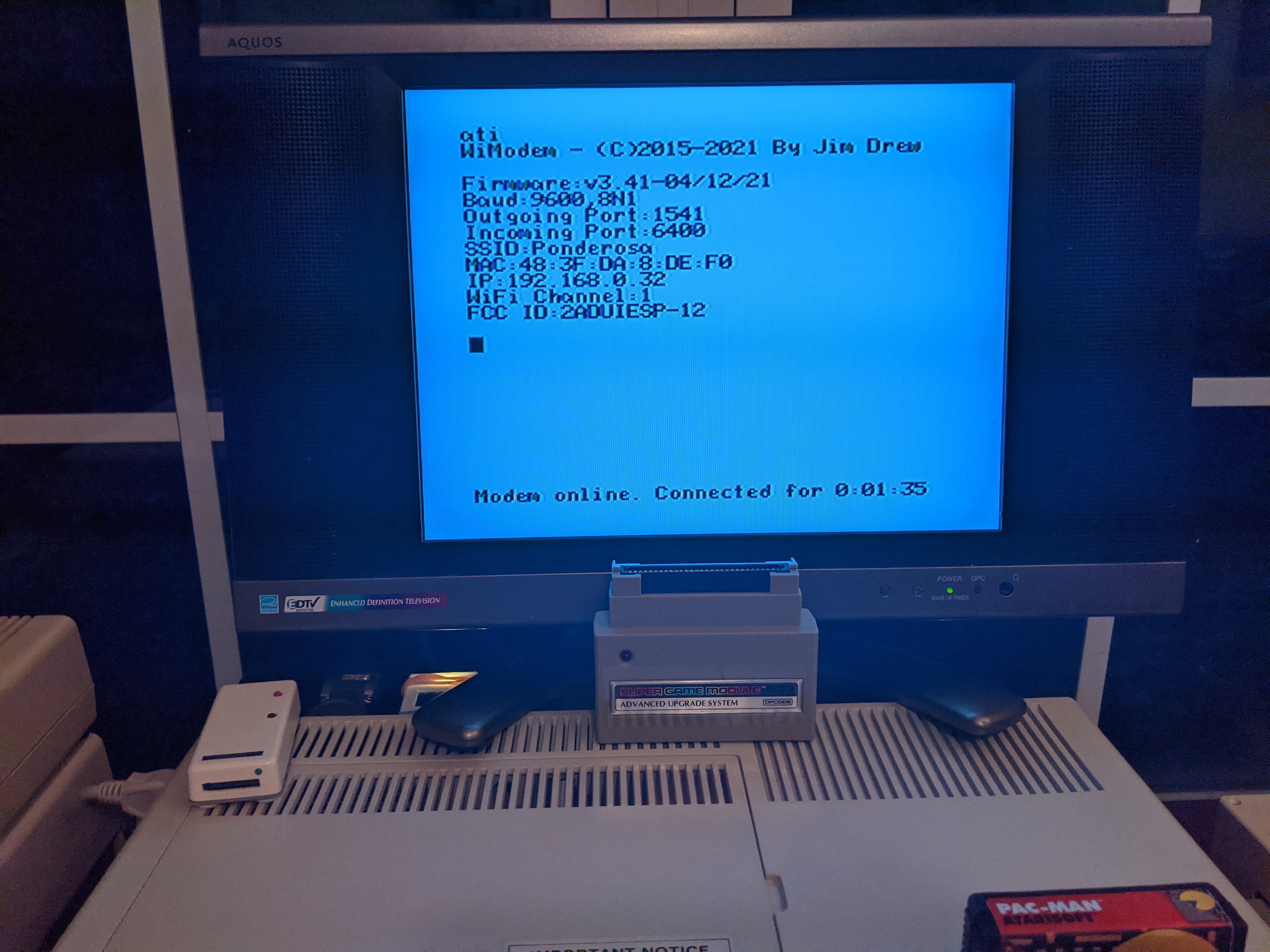

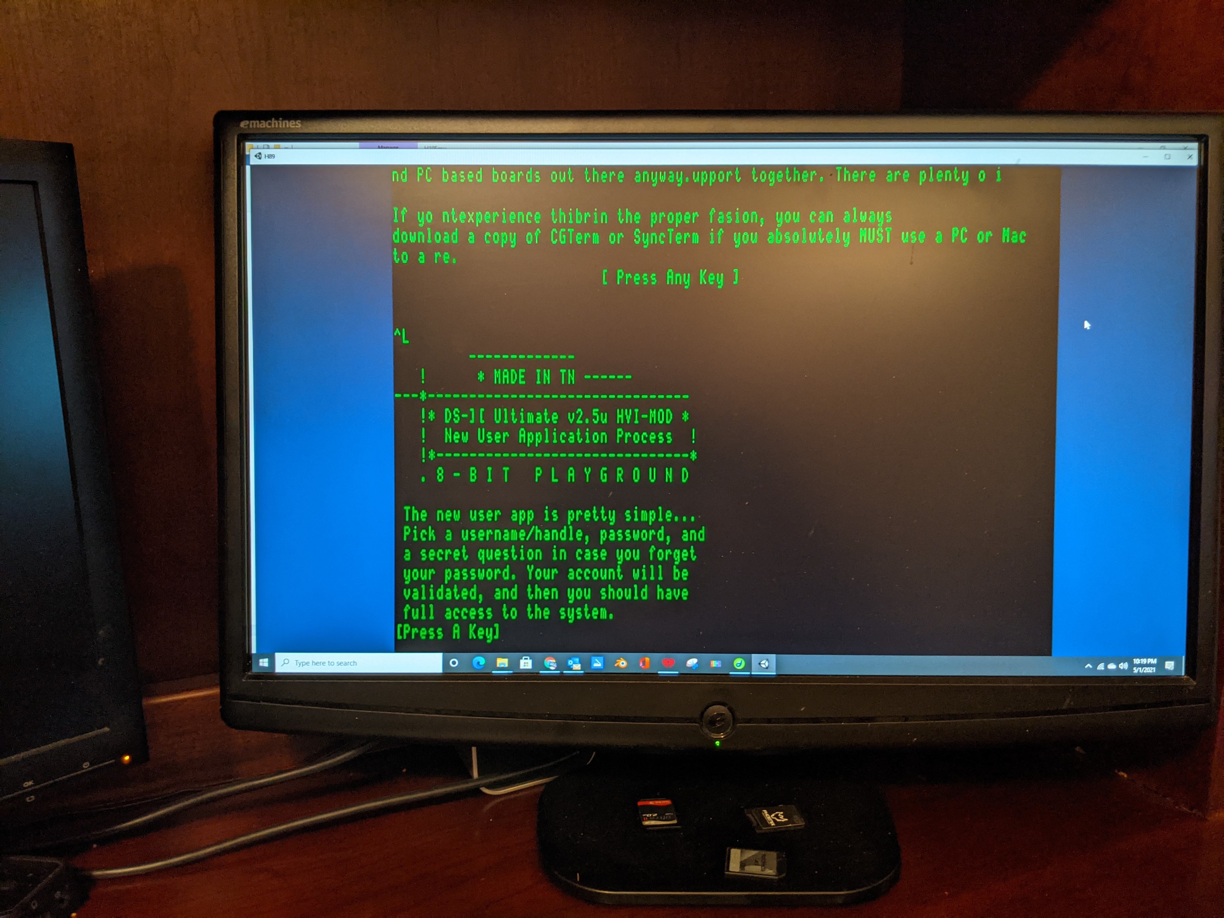

Online at 9600 Baud over WiFi and using 80 Column Terminal on a PC

Audio Balance Fix (SGM/Speech) C88 Fix C88 Fix C88 Fix
